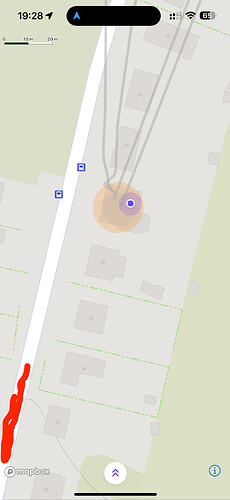

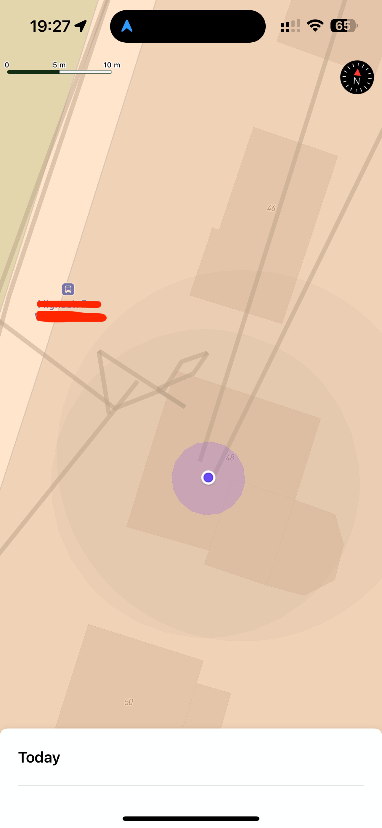

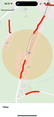

I use both the old Arc Timeline and the new Arc Editor. Despite the redesign of the application, I still have to confirm the location of my home every day.
I live in the middle of the countryside and there isn’t much around apart from a few other houses. And when I edit the square in Arc Timeline, it doesn’t show me anything other than my house. So there’s no possible confusion.
However, I notice that the map display is not identical from one application to another. With timeline, see image, I have an orange circle 20 m in diameter followed by a purple circle a few metres long (see first image). On the other hand, with editor, the orange circle is almost 400 m in diameter (see second image). The purple circle is the same size as in timeline.
I should also point out that these images were taken at the same time.
How do you explain this difference between timeline and editor? And why do I still have to confirm my home again and again? Will this situation be corrected in a future editor beta?

I’m pretty sure the difference will be that in Editor one or more Visits have been incorrectly assigned to the Place, resulting in its various being pushed out inappropriately.
Unfortunately Editor doesn’t have the nice map updating on the Visits List View that makes it easy to find the incorrect assignments and correct them. That’s high on my list of todos, to hopefully fix in the next build!
On this one I’m not entirely sure, but I’m experiencing the same problem. On the maths side the new Place scoring/ranking system in Editor is better than in old Arc Timeline. But in actual use… it feels worse. So I need to keep plugging away at it, doing various tests in different locations, spotting why it’s making worse decisions and fixing it.
I’m pretty sure there’s a mixture of factors - it won’t be just one thing (I’m not that lucky). In some cases it’ll be the weighting of the centre to centre distance scoring, in another case it’ll be the time of day scoring, in another it’ll be the … you get the idea.
In beta 2 I fixed some of it, for one specific case (the place I’m staying at now). But I could tell at the time that I was only fixing that one specific kind of case. It’s going to take more testing to feel out more cases and see where the weighting and scoring is going wrong.
Oh, on the upside, Arc Editor does have the foundations of cool new scoring features. Like, it’s going to be fairly easy for me to add scoring for prior trip and prior place. Like if the timeline is “home → walk → convenience store” or “work → cycle → cafe”, and the cafe and convenience store are right next to each other (making distance scoring not useful enough to tell them apart), then the scoring will be able to look at the walk versus cycle, and home versus work, and say “ok so this visit happened after a home visit and a walk, so it’s much more likely to be the convenience store”.
Arc Timeline doesn’t have any of that smarts. So I’m looking forward to adding those bits to Editor!
