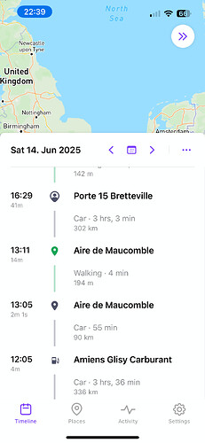

But here‘s a minor bug in the map view. I already noticed it in the previous beta:
Long distance tracks are not displayed, and the the map view focuses on North Sea (in my cases, traveling France)

Unfortunately this is in both beta builds, and is a frustratingly known bug. It’s to do with the new map projection that the newer Mapbox SDK is using.
Arc Timeline app uses an older Mapbox SDK, which uses the Mercator projection. That’s a simple rectangle, so the map can zoom in to any part of it (except the extreme edges) and align to the correct view area.
But in the new Mapbox SDK that Arc Editor uses Mapbox is using a globe projection. So as it zooms out … it doesn’t fit anymore, and the SDK’s zoom feature breaks. If you swipe down the timeline sheet you can see underneath that it’s still zooming to the correct area, in full screen. But when the timeline sheet is in normal position it’s supposed to be taking into account that offset/inset, and the SDK’s zoom breaks that functionality when zoomed out far enough.
So it’s kind of a Mapbox SDK bug. But one that I’m going to have to work around myself (Mapbox simply ignore support requests or bug reports unless you’re paying expensive monthly support contract fees).
Anyway, yeah, known, and annoying! You’ll basically always see the bug when there’s an airplane flight in the day, or a longer train trip.
