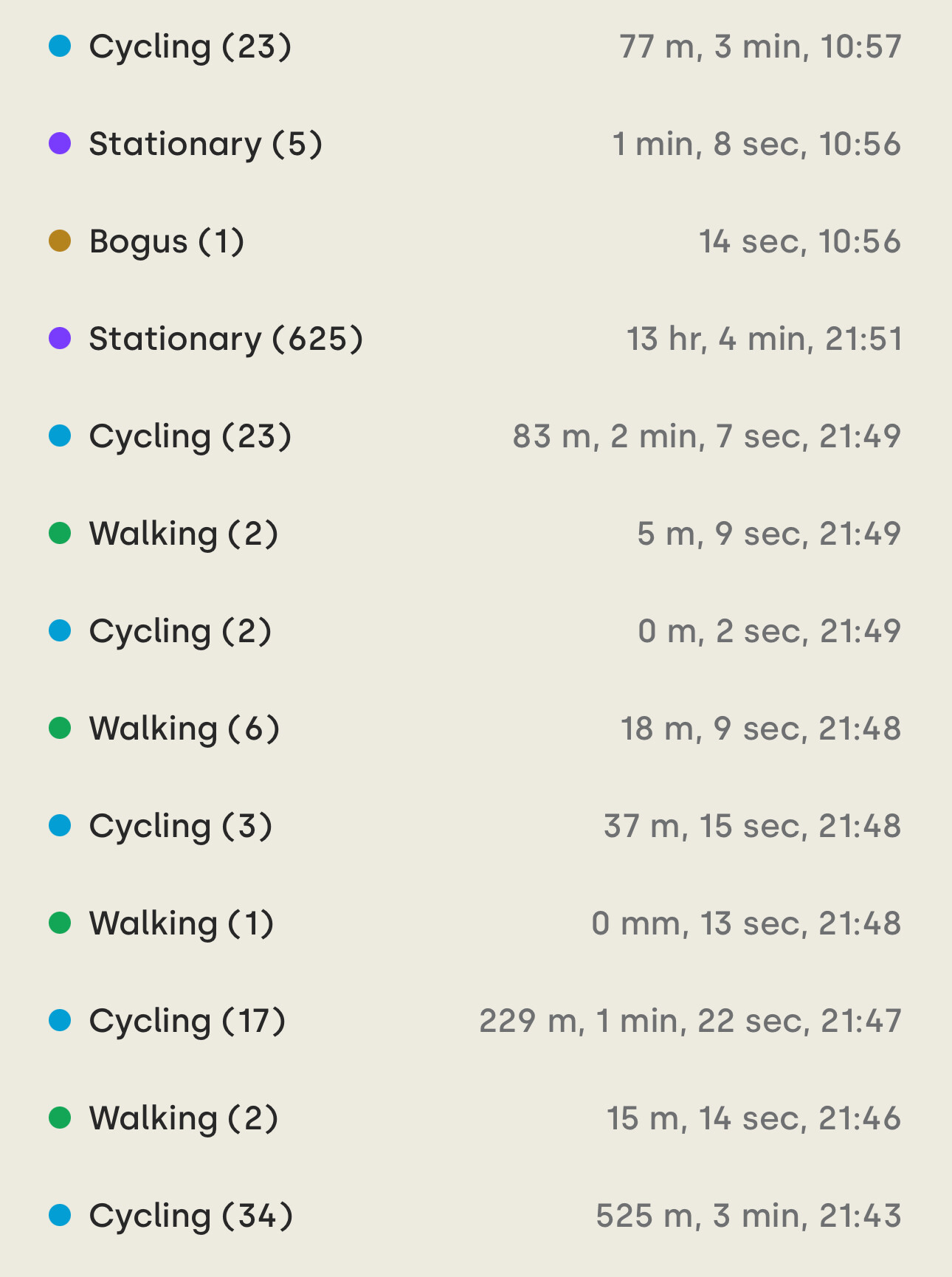

Here is an example you can see
I imported the record to arc, Arc’s record is correct.
I did start cycling at around 21:43 and stay stationary for 13+ hours.
( ignore the cycling at 10:57, that’s i got stuck in traffic in taxi. Which is normal i worlds say)

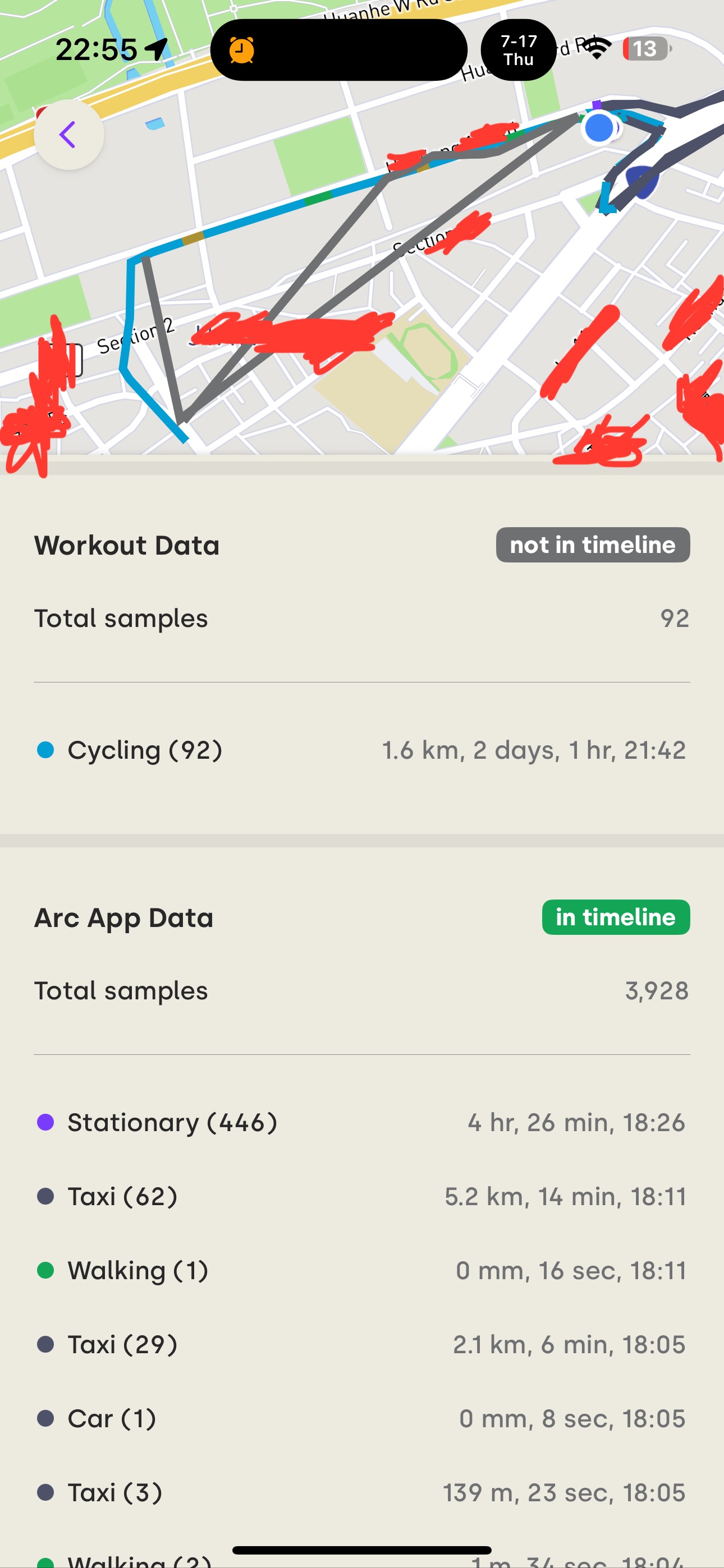

but the imported workout is totally wrong as it shows 2 days 1 hours. If i import that work out, the cycling will last till next day.
I checked the workout in apple fitness app. The record shown inside fitness is correct.
Hmm. Well that’s weird. That “Workout Data” is showing the cycling data (ie the data that came directly from the recorded workout) as spanning 2 days. Which means there’s something wrong in the workout data.
Which I wouldn’t expect from a workout recorded by Apple’s own workout app. And also shouldn’t be possible given the safety check I described earlier (where samples with times outside of the workout’s stated time range are discarded and not imported).

So there’s something I’m missing here… For the workout to show up in the Fitness app (or Health app) with correct start and end times, it can’t be possible for it to import incorrectly into Arc. Any erroneous samples/locations outside of that range will be discarded. So… how it is ending up with that 2 days duration? I’m at a loss. Hmm.
Nope, I’m not having any bright ideas. And I’m not seeing any clues in the code either. It all looks entirely solid. I can’t see any potential gaps in the logic. I’ll have to keep thinking on it. Anyway thanks for the screenshots! Those definitely help.
