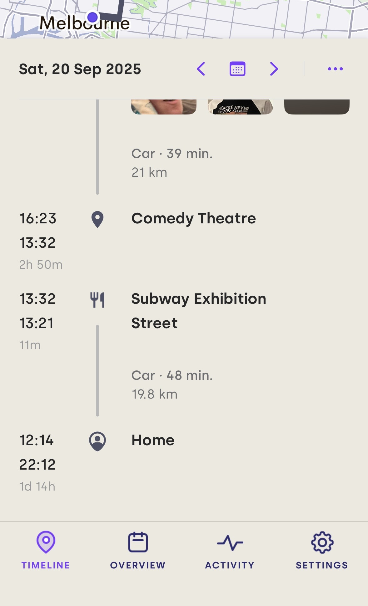

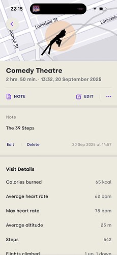

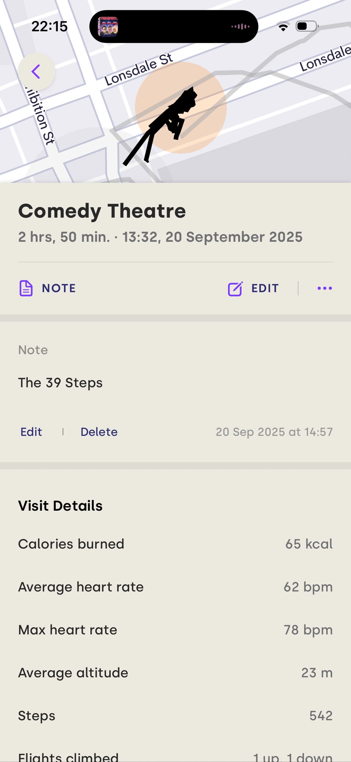

I’m seeing this in my timeline sometimes too. Here’s an example of a timeline with an item (Comedy Theatre) that is not showing its note in the timeline view, but is showing it in the details view:
Hm. Also super weird! I can’t reproduce this here on my phone, nor spot any reason why it would happen. But there it is in your screenshots!
What happens if you swipe the app closed and relaunch it? I wonder if for some reason the timeline view is only partially loading. The notes are loaded separately from the other content, so typically appear just after the main details have loaded. Maybe something is slowing down or blocking the notes loading in some cases…
On a fresh launch of the app, when I navigate to the day with that entry, it initially displays without the note, but then when the view refreshes with the photos the note also appears at the same time.
Once the note is visible, if I tap the entry to view its details, then hit Back to return to the timeline view, the timeline refreshes with the note missing again (but the photos remain on the screen), then several seconds later the note reappears again.
Hm. I think that sounds correct then. Though the delay in notes appearing should be so brief that it’s not noticeable. It sounds like it’s not that brief in your experience. Which means something’s slowing it down. I’m not sure what that is!
