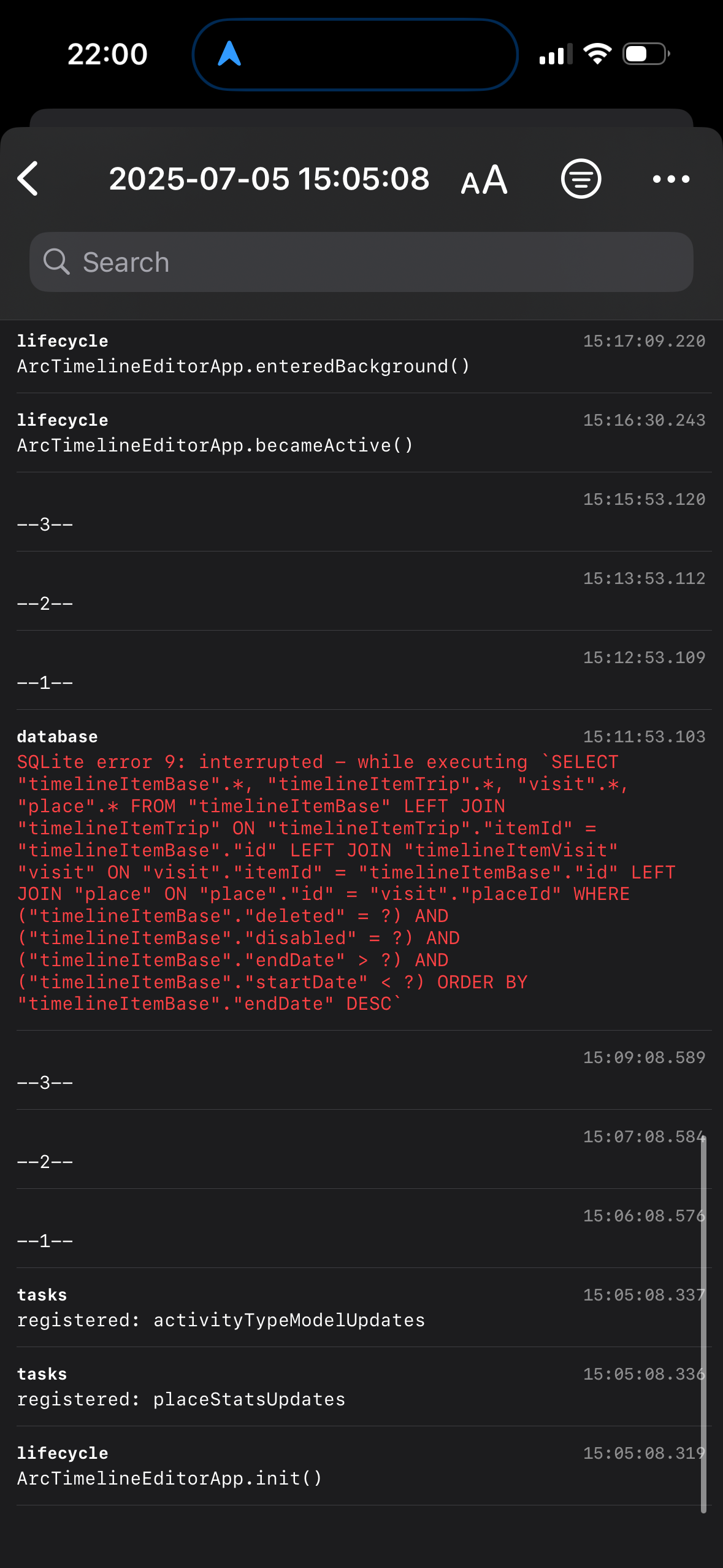

SQLite error 9: interrupted - while executing 'SELECT “timelineItemBase”., “timelineItemTrip”., “visit” .*, “place” * FROM “timelineItemBase” LEFT JOIN “timelineltemTrip” ON “timelineltemTrip” “itemId” = “timelineItemBase” “id” LEFT JOIN “timelineltemVisit” “visit” ON “visit” “itemId” = “timelineItemBase” “id” LEFT JOIN “place” ON “place”.“id” = “visit” “placeId” WHERE (“timelineItemBase” “deleted” = ?) AND (“timelineItemBase” “disabled” = ?) AND (“timelineItemBase” “endDate” > ?) AND (“timelineItemBase” “startDate” < ?) ORDER BY “timelineItemBase”. “endDate” DESC

The “interrupted” one, was that just before/after a CancellationError()? Those are supposed to all be caught and dealt with. If they slip through to the log file it means I haven’t properly handled a case.
Entirely harmless, but it’s something that’s meant to be very deliberate, ie whether a database action is allowed to be automatically cancelled or not. Like, if it’s just reading in data for display in the UI, then usually that’s fine to be cancelled (eg you tapped through to a different view before it finished, so there’s no need for that data anymore). And in those cases I’m meant to be catching the CancellationError() and saying “meh, that’s fine; ignore it”. If it gets to the log file it means I haven’t done that!
Anyway, I’m rambling :joy: Hopefully I’ll see that one myself soon, and realise where it is in the app and clean it up.
Screenshot of the interrupted error.
I figured the errors weren’t too much of a concern and you’d probably find them eventually on your own.
Oh weird, no CancellationError() before or after. I wonder what that’s about. Still looks harmless though - it’s just a query that’s loading data presumably for UI.

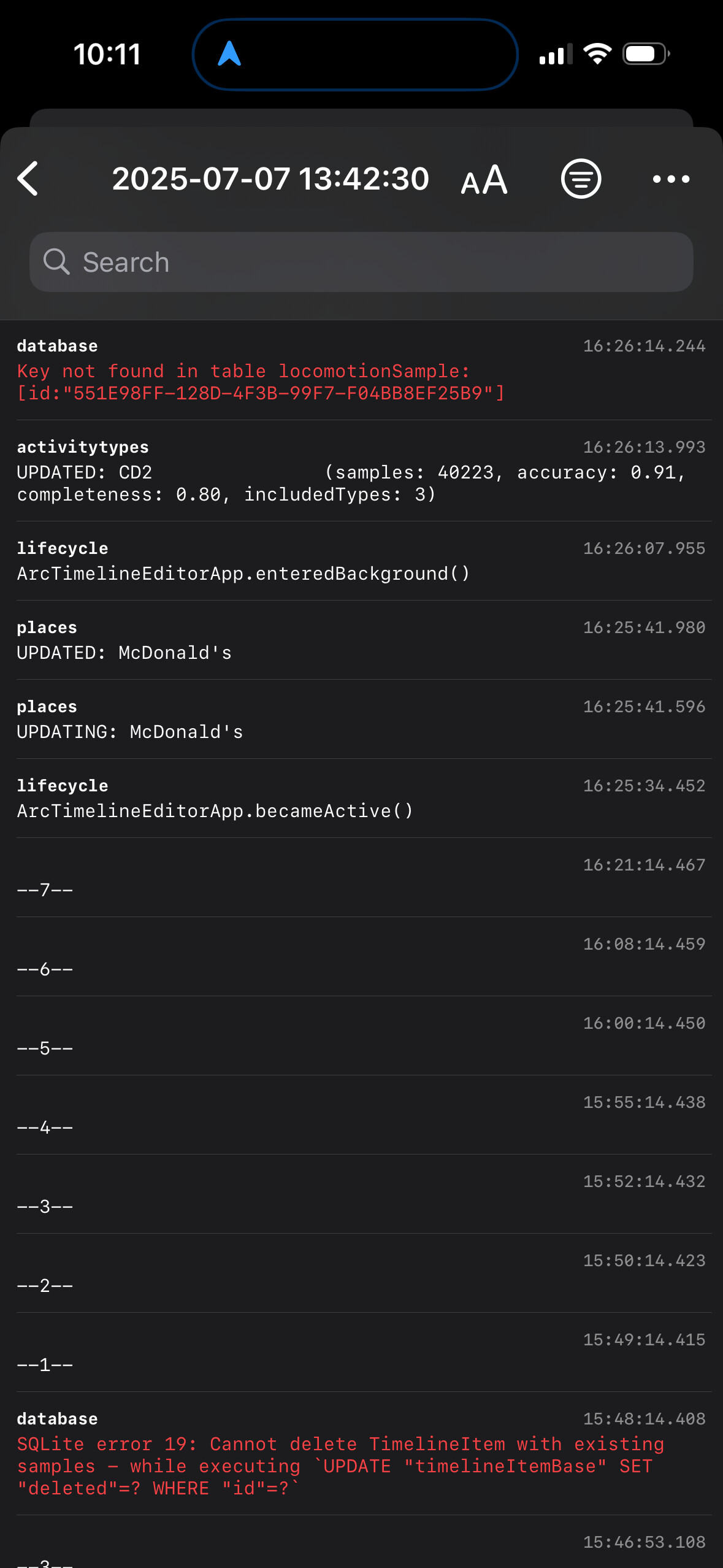

Matt,
I found this error in the logs of beta 1 which I assume might still be there. Once I switched phones without an iCloud backup and then had to do a restore. Maybe it is from that. Perhaps it is not significant yet I’m not sure if maybe anything might be missing somewhere or if there might be some future way to correct such.
@agastya Ah that “key not found in table” sounds worse than it is, thankfully. Though it does annoy me, in the sense that I’m not sure why it happens. But it is thankfully just a harmless side effect of something of low consequence.
I think, from memory, it’s something in the ActivityType model updating. When the system is collecting up samples for the model training, sometimes it thinks there’s a sample that … isn’t. Harmless, but super weird.
Ah yeah in your screenshot the line just before is a model update. Though I would’ve expected the error to come before the update completes. Hmm.
Anyway yeah, it’s another minor “eh?” thing for me, rather than anything to worry about. I’ll keep chipping away at these over time. There’s only a small handful of them still present, and all of them (that I’ve seen) are non-issues. Just signs that I’ve got a slightly sloppy bit of code somewhere, that should be a bit more tidy.

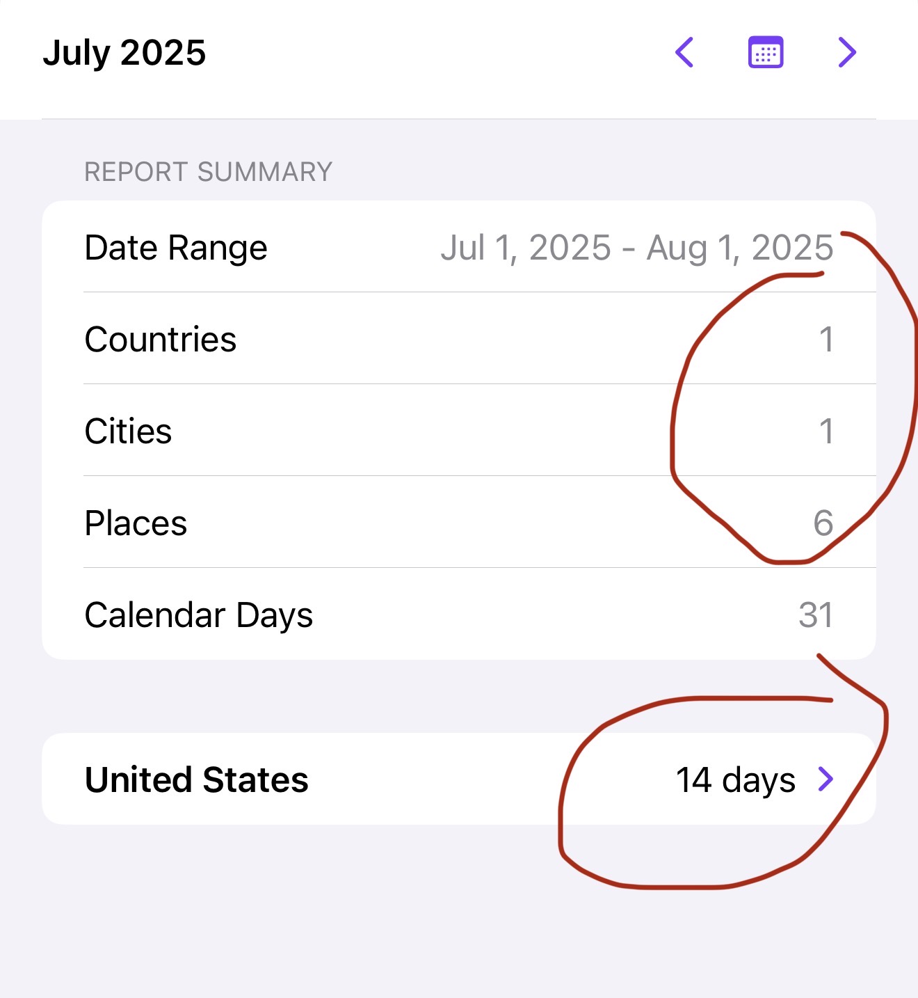

When will these data updated? especially the places number. that is way less than the real places I visit in a month.
It should be updated when the Places get updated, during the scheduled background task. But I think what’s happening is the reverse geocode service that it uses (Apple Maps server side API) is rate limiting the requests, so only a handful of them get done. Which means the Places get marked as updated, but the reverse geocode for them hasn’t happened.
You can work around it by going into the edit view for various Visits in areas where you can tell the report is missing. When the place results list is loaded any places in the list that are missing reverse geocode data will have that filled in (as long as the Apple Maps API doesn’t rate limit again).
So what I’ve been doing for myself is noticing when the report is missing a country or city, or its showing a number of days that I know is too low, then going to the timeline view for those days and tapping into the edit view for one or two visits. That’s enough to get that information available to the report.
Eventually there’ll have to be a better system for working around those rate limits. But yeah, for now in these early betas, if the rate limits hit, the reverse geocodes just get forgotten until you open a relevant edit view.
Oh this is only for Places that were imported from the old LocoKit database. For new Places added after Arc Editor was installed, those should all have reverse geocode data done immediately. They’re not added fast enough to hit the rate limits most of the time.
So it’s just that massive chunk of hundreds or thousands of imported Places that trigger the rate limiting.
Do you mean go to the day view? Or do you mean to go to each visit that is not counted inside the places? I tried to go to the day view but seems not work.
And yes, all imported from old data so they almost all missed
