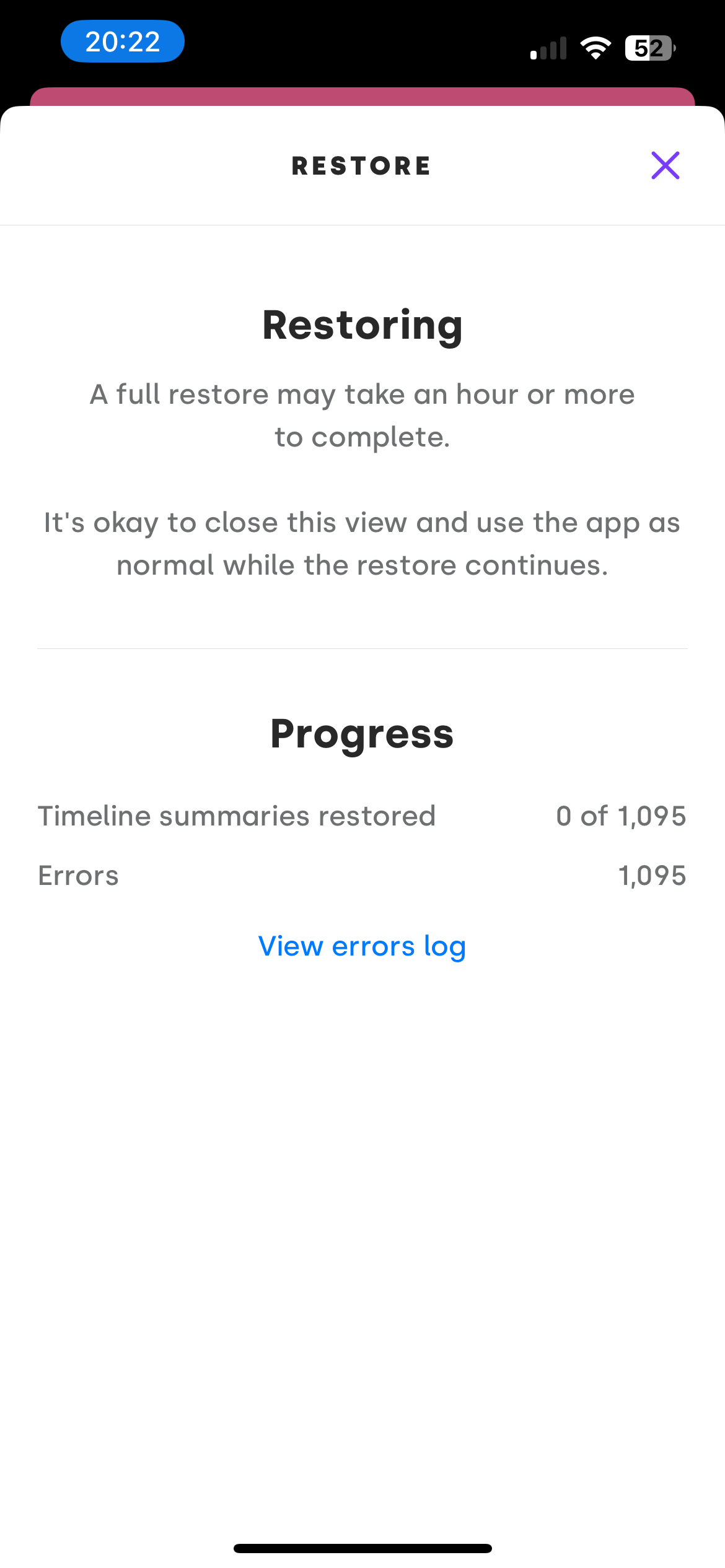

My iPhone was recently repaired and enough components were replaced that it was effectively a new phone and thus I restored from iCloud. Following this, I get a dialogue saying a restore folder was found, when I try to restore it tells me errors were found and when I try to view the error log, it’s empty. I think I did a successful Arc restoration following the iCloud restoration but it seems to be stuck on these errors as the message and dialogue doesn’t go away. strong text
Hmm. “0 of 1095” is a quite bad result.
