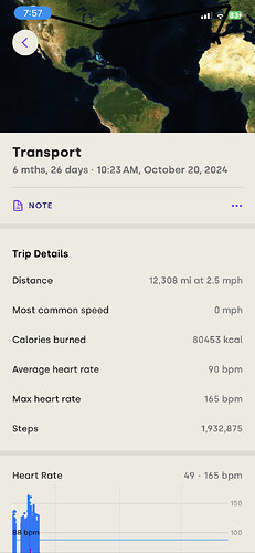

For those curious what a year abroad looks like as a single import;
Yes it shows my average Rem sleep per night for the whole year. Yes it shows a very dubious heart rate graph. Where did it get this data? Who knows.

I think there’s some weird race condition with old Arc Timeline’s heart rate data fetching sometimes. Like, it fetches it for the item’s date range, but then… actually I’m really not sure. It’s odd. But yeah when I’ve seen similarly weird heart rate graphs like that they’ve always disappeared on their own shortly after, when Arc updates the fetched heart rate data.
Though for a 6 month long item, that might be a big ask! Arc isn’t really built to cope with items that long :grimacing:
