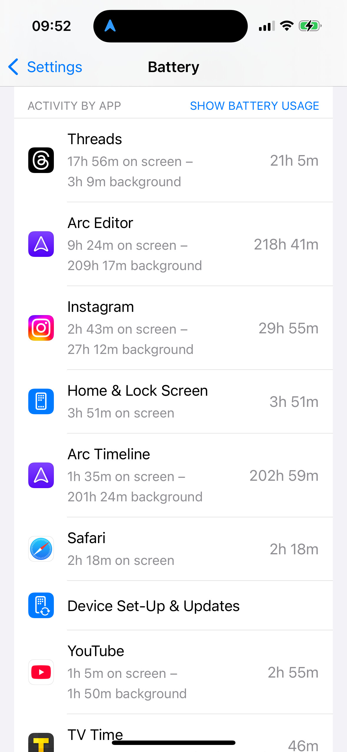

Anyway, yeah that’s the next thing I’d check. In the Settings Battery view, how much screen time is it showing for Arc Timeline over the past 24 hours and 10 days? It’s the screen time that chews up almost all the energy use. Like, 5 minutes of screen time could potentially chew up just as much battery as 5 hours of background recording.
For context, here’s screenshots of what my 10 day Settings Battery view looks like.
This should represent very high usage, given that I’m working on both Arc Timeline and Arc Editor for part of each day, and testing both of them throughout each day. The screen time numbers for both of them look suspiciously low to me. But… no way to validate whether it’s giving correct data or not.
